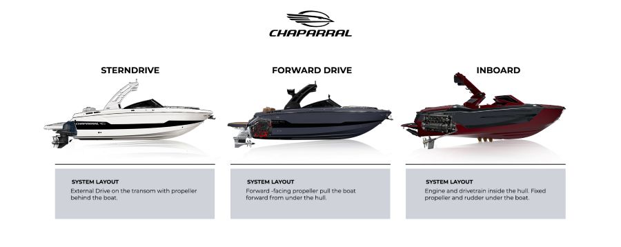

Sterndrive
A sterndrive, also known as an I/O (inboard/outboard), connects the engine to an external drive unit mounted on the transom. This drive unit contains the propeller and can turn for steering as well as trim up and down to adjust the boat' running angle.
Inboard
An inboard system keeps the drivetrain fixed inside the boat, using a straight driveshaft underneath the hull connected to a propeller and rudder. Because the propeller remains fixed beneath the boat, steering is handled by the rudder rather than the propulsion unit itself.
Forward Drive
While it operates similarly to a sterndrive, the forward drive positions its dual forward-facing propellers beneath the hull rather than behind the transom. This design moves the propellers away from the swim platform and stern area while retaining the trim capability, handling characteristics, and general layout of a sterndrive system. Forward drives are commonly used in watersports applications, where their configuration supports towing activities while maintaining familiar sterndrive-style handling.
Comparison Image
